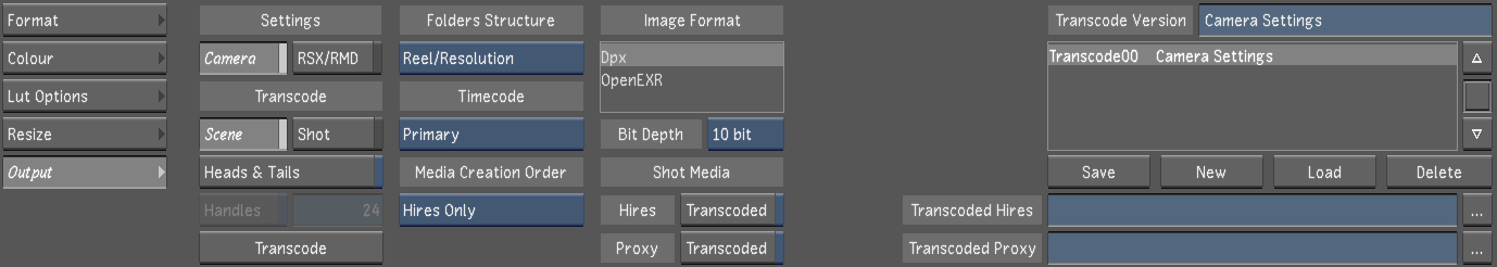

Use the Output settings to set an output destination for your transcode job and to change how the timecode is used.
For information on the Settings and Transcode options, see Transcode Options.
| Select: | To: |
| Reel/Resolution | Establish a <reel name>/<resolution> folder structure. This is the default option. |
| Reel/Shot/Resolution | Establish a <reel name>/<file name>/<resolution> folder structure. |
| Select: | To: |
| Primary | Select either the Time of Day or Edgecode timecode. Only select this option if you know which timecode has been set as the primary. |
| Time of Day | Establish a timecode field that is set by the internal clock from the RED camera. |
| Edgecode | Establish a timecode field that is set by the camera operator. |
| Select: | To: |
| Proxy/Hires | Transcode the proxy media for all the shots first, and then the high-resolution media is transcoded. |
| Hires/Proxy | Transcode the high-resolution media for all the shots first, and then transcode the proxy media. |
| Hires only | Transcode only the high-resolution media. This is the default and recommended media creation option. This allows you to work on the native proxy as the high resolution is transcoded. |
| Proxy only | Transcode only the proxy media. |
Enable to view the Hires/Proxy transcoded media and disable to view the original RED media.
Use to save, update, load and delete Transcode versions to apply to your media. See Transcoding Versions.
| Transcode to: | Type: |
| Wiretap Server | <server_name>@wt:/stonefs/Test_transcode/Transcode |
| Wiretap Gateway | <server_name>@wtg:/mnt/md0/transcode |
