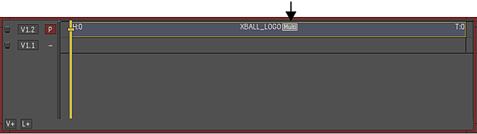

A multi-channel clip is a source clip that contains one or multiple matte channels. Add matte media to source clips in the Lustre timeline to create a multi-channel clip and use the matte for secondary colour grading and effects. See Working with Mattes.
On the timeline, the multi-channel clip is labelled Multi.
On the storyboard, the multi-channel clip is labelled Multi.
When you create a multi-channel clip, the source clip is modified in the library. Next time you use the source clip, the matte will be available. Any modification done inside the multi-channel clip is replicated in the library source clip.

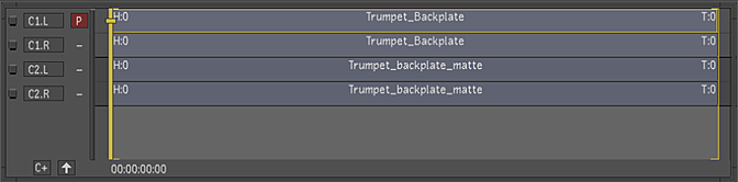

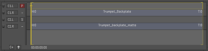

To create a stereoscopic multi-channel clip:

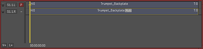

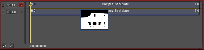

A "multi" icon appears on the Stereo timeline segments, but only one of the stereo sources is updated in the Library.
If you open the multi-channel clip, you see that the channels for the other eye are empty.

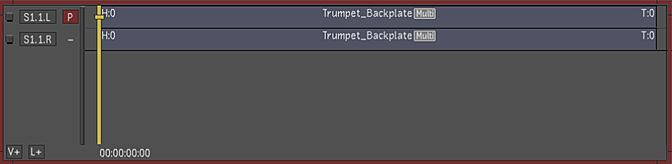

A "multi" icon appears for the other stereo source in the library.
If you open the multi-channel clip now, you see that the front and matte clips for both.

The matte media is located on the Secondary video channel (C2).
