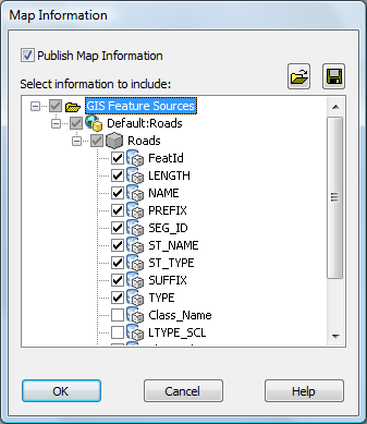

  2. Click Output tabExport To DWF/PDF panelExport To DWF/PDF Options (MAPDWFOPTIONS).
  3. In the Map Information dialog box, select Publish Map Information.
  4. In the Map Information dialog box, expand the items in the list and select the Roads and Parcels items.
    You can include and exclude information at any level.
    Notice that when you select Roads, everything under Roads is automatically selected.
  5. To publish the information to an XML file, click the file icon at the upper-right in the dialog box (Save). Specify a location for the published file. Click Save.
    The DWF Publish operation uses the XML file.
  6. Click OK in the Map Information dialog box.
