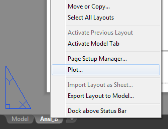

  3. Right-click the layout tab labeled Ansi_A and select Page Setup Manager to specify plotter and paper information.
    Right-click the layout tab for the map book and choose Page Setup Manager.
