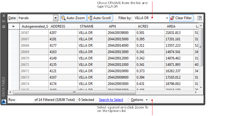

  3. In Display Manager, select the Parcels layer and click Table.
  4. In the Data Table, in the Filter By list, select the STNAME field and enter VILLA DR into the field.
    Do not spell out the word “Drive.”
  5. Click Apply Filter to show only parcels on Villa Drive.
    Use the Data Table to filter the parcels you see.
  6. Make sure Auto-Zoom is on.
    This button is outlined when it is on.
  7. Click in the dark-gray, left-most field for a parcel to select that parcel.
    Note: Scroll the Data Table to the left to see the left-most fields.
    AutoCAD Map 3D zooms to the selected parcel.
  8. Make a note of the number in the Autogenerated_SDF_ID field, because you will need it again later.
