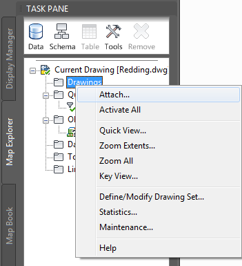

  3. On the Map Explorer tab of the Task pane, right-click the Drawings folder. Click Attach.
    Attach drawings from the Map Explorer tab of the Task pane.
