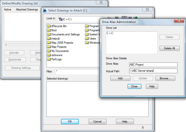

  4. In the Select Drawings to Attach dialog box, click (Create/Edit Aliases).
  5. In the Drive Alias Administration dialog box, type a name for the alias.
    The name must use only alphanumeric characters (including hyphen and underscore), contain no spaces or colons, and start with a character. For example, you can call the alias TutorialData.
  6. Specify a path for the new alias.
    In the Drive Alias Administration dialog box, specify a name for the alias and the actual path it represents.
    In this example, use the path to the folder where you copied your tutorial files.
  7. Click Add, and then click Close.
  8. Click OK in the remaining two dialog boxes.
    The drawing location is now mapped to your drive alias. You can now open drawings in that folder without defining any further aliases.
