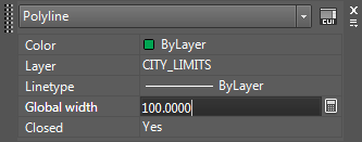

  4. Select the value for Global Width, enter 100, and press Enter.
    You can edit values in the Quick Properties window.
  5. Press Esc to close the Quick Properties window.
    The polyline displays at the new width.
