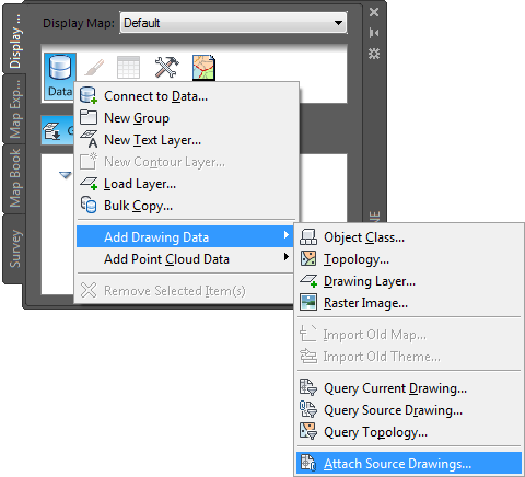

To attach an AutoCAD drawing file
  1. If you have not already done so, copy the sample files to a local folder.
  2. In the build_map1.dwg file, in Display Manager, click Data > Add Drawing Data > Attach Source Drawings.
  3. In the Define/Modify Drawing Set dialog box, click Attach.
  4. Navigate to the folder where you copied the sample files and select Counties.dwg.
  5. Click Add and then click OK.
  6. In the Define/Modify Drawing Set dialog box, click OK to attach the drawing file to your map.
