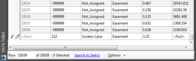

  2. Click in the new blank row in the Data Table.
    If the Data Table is minimized or docked, click its Show/Hide icon to display it. Scroll to the bottom of the Data Table to see the new entry.
  3. Fill in the data fields for this parcel.
    Look at the other entries to see what a logical entry would be for each column. Making changes to the parcel properties checks the parcel out automatically.

You have added a new parcel and updated the parcel data to reflect your changes.
A new Data Table entry
