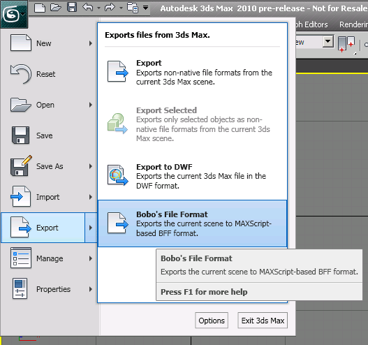

For example, to add a new option to the Application Menu > Export sub-menu to write the scene to the 3 rd party BFF file format, you could add the following to the \ui\ApplicationMenu.xaml file inside the definition starting with the header
<ApplicationMenuItem Text="Export" IsSplit="true" Id="ExportSplit" ...
<ApplicationMenuItem Text="Bobo's File Format" Id="BFFExp" KeyTip="B"
LargeImage="Icons/ApplicationMenu/export_32.ico"
Description="Exports the scene in the MAXScript-based BFF format."
CommandHandler="{wpfmax:ActionItem MacroCategory=Bobo_s Tools, MacroName=BFF_Exporter}"/>
After re-saving the XAML file, opening the3ds Max Application Menu shows the following additional command:
