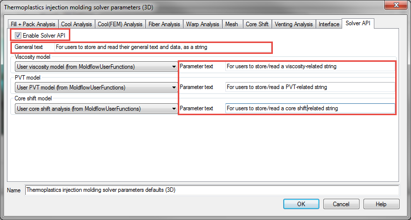

To use these solver API options, enable them on the Solver API tab, which you can find in the Advanced options of the Process Settings. The API options are ignored unless you enable them here.
The General text string is always available when the Solver API is enabled. The Parameter text strings are specific to each API option, and are only available when you enable that API option.
For 3D Flow, you can now call your own code during an analysis without turning on the PVT, core shift or viscosity options. For example, you can extract additional data from a standard analysis, process them for your own unique needs, and write them to a file.

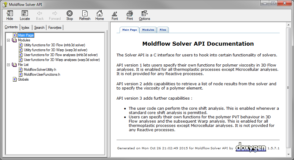

You can access help on the scope of the solver API and how to use it, in the User's Guide. The help also includes a description of the example projects.
Note: You can find detailed documentation of all the user and utility functions in the Solver API Reference located in the help menu in Synergy.
