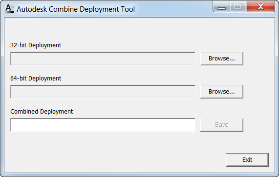

  1. Create separate 32- and 64-bit deployments from the product installers and store them in the same deployment folder. Include either 32 or 64 in the deployment name to clearly designate the type.
  2. In the deployment Tools folder, double-click the CombineDeploy.exe tool.
  3. In the tool panel, browse to the 32- and 64-bit deployments, and then enter a descriptive name for the combined deployment.
    The combined deployment is saved in the same folder as the 32- and 64-bit deployments.
