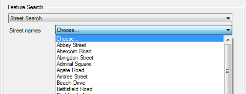

In the Feature Search group box, you can specify a map center by selecting a certain object. The searches can be defined with the Feature Search Administrator. This search is of the search type sequential with input type combo box.
