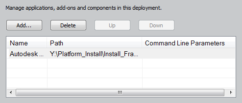

    You see a table in which to manage the software.
  3. Above the table, click Add, browse to the file location, and then click a file.
    The filename and path are added to the management table. Repeat this step to add more files.
