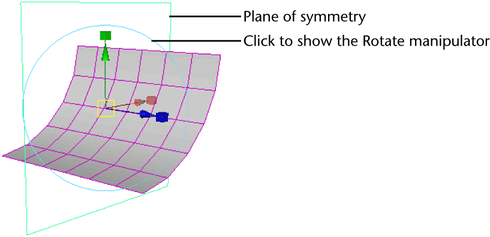

Using Cut Geometry to create a symmetrical mesh interactively
You can model a polygon mesh and then copy it across a user-defined axis of symmetry using the Cut Geometry feature in the Mirror Options. The Cut Geometry feature lets you manually position the axis that the mesh will be duplicated across. You can see the copied mesh "mirrored" on the other side of the axis of symmetry, and then move the axis to slide the two objects together or apart, changing the shape and location of the intersection. You can delete the axis and the copied mesh to cut the original object along the axis. You can also merge the duplicated mesh with the original mesh to create one resulting polygon mesh. Cut Geometry can provide for interesting symmetry results depending on where you position the axis of symmetry.
To model a polygon mesh symmetrically with Cut Geometry
  1. Select a polygon mesh.
  2. Select Mesh > Mirror > .
  3. In the Mirror Settings section, turn on Cut Geometry. Also turn on Mirror Cut Plane if you plan to make further alterations to the axis of symmetry later.
  4. Click Mirror.
  5. Use the manipulator to adjust the plane of symmetry.
    Note:
    • If you move the plane of symmetry so far that it occludes all of the original object, going beyond the "positive edge" (last remaining edge), then both the original object and its mirror image will disappear (except for one face on each). If you want to mirror the object in the direction of its positive edge, then move the symmetry plane so it intersects the original object and rotate the symmetry plane 180 degrees.
    • When you delete history of an object on which you have applied a Mirror Cut Plane, the plane of symmetry is not deleted. You must manually delete the plane of symmetry.
