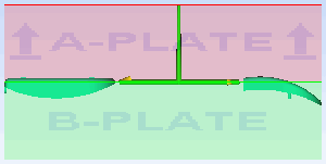

  1. Click Set Parting Plane, Geometry tab (Geometry tab > Mold panel > Set Parting Plane). The Set Parting Plane dialog appears and the model is oriented to a bottom view.
  2. Enter 28 mm in the Z depth of plane box, then click Apply to move the parting plane, as shown below.
  3. Click Close to exit the Set Parting Plane dialog. We will use the default mold properties for this tutorial.
