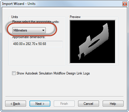

  8. Confirm the units are Millimeters.

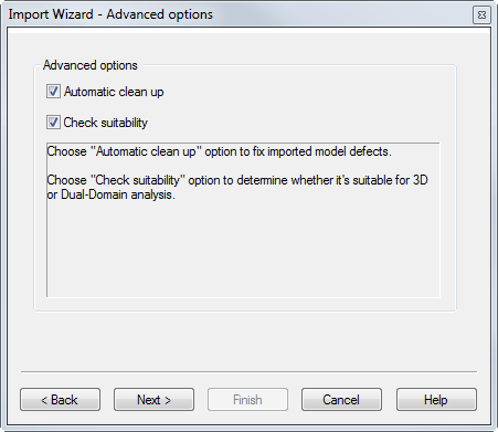

  9. Click Next on the Advanced options page.
    It takes a few seconds for the cleanup and checks to take place.

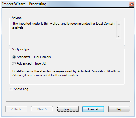

  10. Click Finish to accept the analysis type as Standard - Dual Domain.

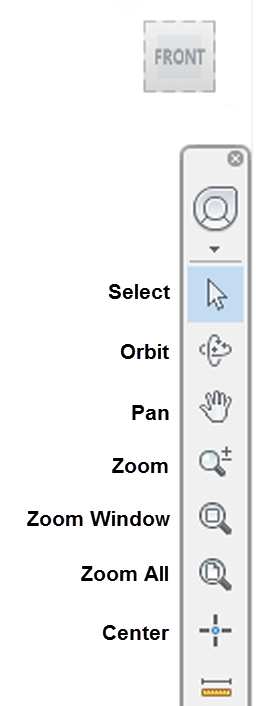

  13. Use the View Cube and Navigation bar on the right to move the model around the screen.
