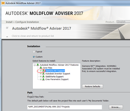

Launching Autodesk Moldflow Adviser from your Siemens NX10 Product
Quick launch has been added to Siemens NX10 so that you can launch Autodesk Moldflow Adviser from within your CAD system.
Once you are finished with your CAD design within Siemens NX10, click the Autodesk Moldflow Adviser icon from within your CAD system.
Note: To ensure the installation of this Quick launch, make sure that the Siemens NX Support box is ticked while installing your Autodesk Moldflow Adviser package.
