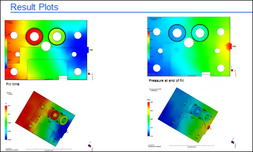

Use the FourPlots command to add four different results plots to your report.
The format for the FourPlots command is:
FourPlots, <Plot Name>, <Orientation>, <Plot Name2>, <Orientation2>, <Plot Name3>, <Orientation3>, <Plot Name4>, <Orientation4>, where <Orientation4> is an optional argument. If you use a saved view that you have created yourself, use quotation marks around the orientation argument.
