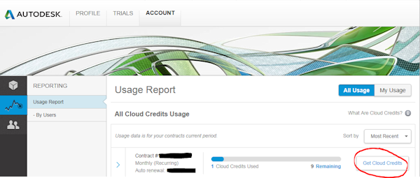

To purchase through the Autodesk eStore, visit https://accounts.autodesk.com. Go to your Autodesk Account and select Get Cloud Credits from the Usage Report page for the desired contract. This selection takes you through a guided purchase experience.
Note: Only contract administrators or software coordinators can buy cloud credits.
