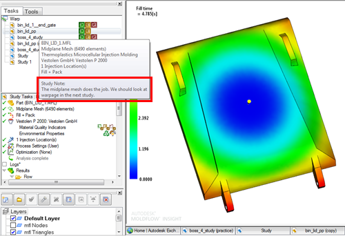

You can create study notes to remind you of important facts about a study. To work with study notes, you must have an open project with at least one study in it. Once open, you can write whatever you want in the notes and the information is saved automatically.
() and select Notes from the list. or
() and select Notes from the list. A dialog appears with information about the study. If there are study notes associated with the study, they will appear at the bottom of the dialog under the heading Study Note.
