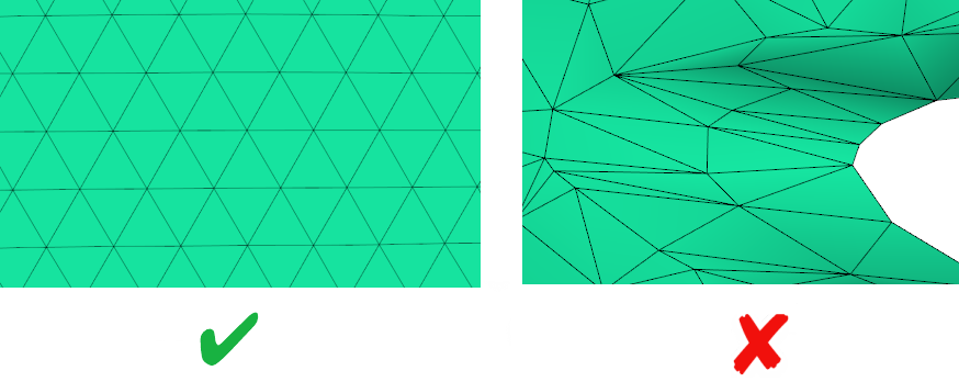

The accuracy of Autodesk Moldflow analyses depends on the shape of meshing elements.
Diagnostic
Visually inspect your model or use the Aspect Ratio Diagnostic tool to detect problems in the element shapes.
Solution
High aspect ratio and too close centroids errors are often due to very small features, slivers or fillets.
