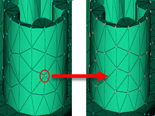

Expand selection to nodes on the same surface
Use the Nodes on Same Surface tool to select all nodes on the same surface of a feature.
Use this tool, for example, to select all surface nodes before applying boundaries condition.
The Nodes on Same Surface tool is supported for the following mesh types:
Note: This feature does not apply to beams.
  1. Make sure that the relevant layers are visible. Invisible nodes are not selected.
  2. Select a node on the interior of the surface.
  3. Click (Mesh tab > Selection panel > Expand to) and select Nodes on same surface from the drop down menu.
