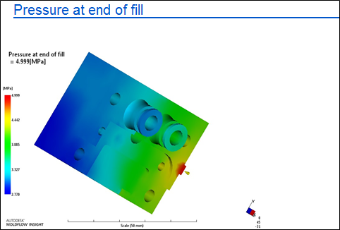

Use the OnePlot command to add a single result plot to your report.
The format for the OnePlot command is:
OnePlot, <Plot Name>, <Orientation>, where <Orientation> is an optional argument. If you use a saved view that you have created yourself, include quotation marks around the orientation argument.
