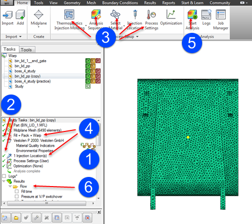

The
Study Tasks pane displays information about the active study.
The Study Tasks pane opens by default when you open a study
- It is found on the left hand side of the model pane. It lists the tasks that are required prior to launching an analysis.
- As you complete each task, a green tick is displayed next to that task.
- Each task can be initiated either from the various ribbon tabs
- or by right-clicking on the item in the
Study Tasks pane.
For example, if you right-click on the
Analysis Sequence icon, you can change the analysis sequence. Alternatively, you can perform the same task using the ribbon menu by clicking
- When all tasks have been completed,
Start Analysis
becomes active.
You can then launch the analysis by selecting the
Start Analysis icon.
- When the analysis has completed, the results are displayed in a folder in the
Study Tasks pane.
