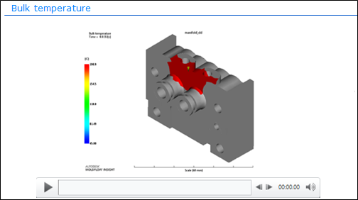

Use the OneAnimation command to include an animation of the result plot in your report.
The format for the OneAnimation command is:
OneAnimation, <Plot Name>, <Orientation>, where <Orientation> is an optional argument. If you use a saved view that you have created yourself, include quotation marks around the orientation arguments.
