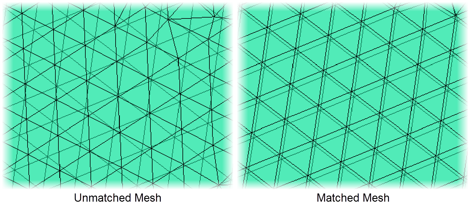

Figure 1: Dual Domain mesh before and after using Imprint tool
Use Mesh Statistic dialog to see what percentage of elements are successfully matched, and the Mesh Match diagnostic tool see the mesh match results graphically. The goal is to maximize this percentage, but there is no threshold limit. In general, if the ratio is <80%, investigate why and try to improve it. It may not be possible to increase the match ratio for chunky models.
