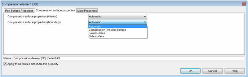

The surface of your model must be assigned the property type "compression surface" to run a compression type molding process.
If the automatic option does not assign the compression surfaces properly, then you can try assigning the surfaces yourself. The software determines the property of the various model surfaces, based on the property of the surface nodes. Nodes are either interior to the selection or on the boundary.

If you select the red elements above and assign both the interior and boundary nodes the compression (moving) surface property, then nodes A-G will all have that property.
If you select all the beige elements above and assign both the interior and boundary nodes the fixed surface property, then all the beige nodes, and nodes B-G will be assigned the fixed surface property.
