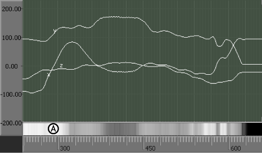

After creating a Rigid body, you can monitor its quality in the Optical editor.
To monitor Rigid body quality:
- Select Settings from the Optical Options pane.
- Click Show Rigid Body Quality.
A. Rigid Body Quality option selected
A bar appears at the bottom of the Optical editor indicating the quality of the selected Rigid body.
Optical editor
A. Quality bar
