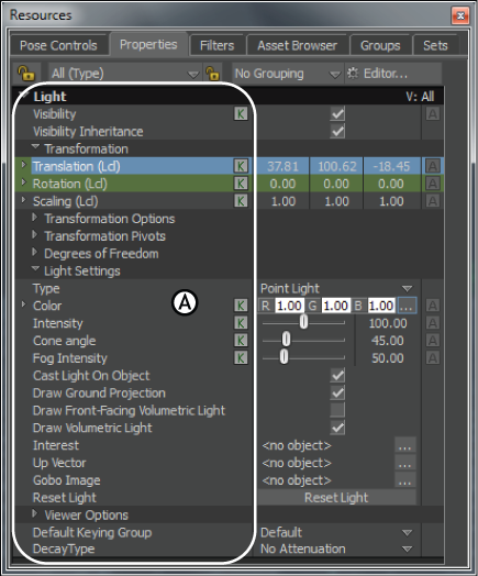

For example, the following figure (A) displays the properties of a selected light in the Property list.
Properties window A. Selected light’s properties

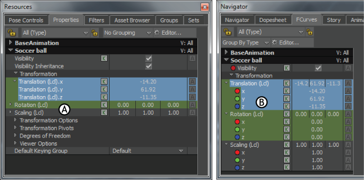

The Property list in the FCurves window displays properties differently than in the Properties window. In the Properties window, a property’s name is listed to the left of its settings.
Property lists A. Property list in the Properties window B. Property list in the FCurves window
In the FCurves window, each property with a function curve also has a Color button, which indicates the color of the property’s function curve.

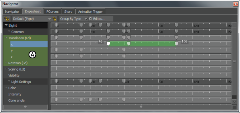

Dopesheet window A. Dopesheet Property list
