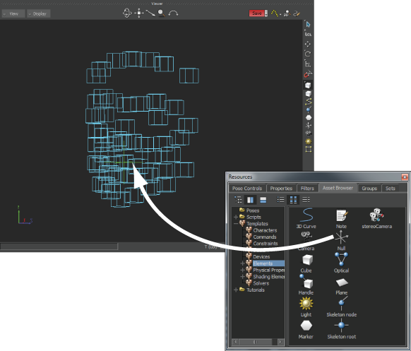

- From the Elements folder in the Asset browser, drag a null into the scene. Since the null will be the Reference object, make sure it faces the same direction as the motion data markers.

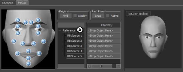

- In the Actor Face settings, switch to the MoCap pane and expand the Reference group.  MoCap pane in the Actor Face settings A. Expand the Reference group.
-  Alt-drag the null from the Viewer window into the Reference slot.

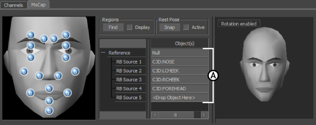

- Identify a group of markers that do not move relative to each other, such as the forehead markers, and drag them into the series of Rigid body slots (RB Source 1, RB Source 2, and so on) in the Reference group.  Actor Face settings A. Rigid body sources
- After you set up the face reference, you can go on to define the rest of the facial Marker set.  See Creating a facial Marker set.  When you play the motion data after setting up the Marker Set list and defining regions, the reference moves with the markers.
To add multiple Rigid body markers simultaneously:
- Select multiple markers and Alt-drag them into a Rigid body slot.
- A dialog box appears giving you the choice to Overwrite, Merge, or Cancel. - Select Overwrite to replace any existing sources in the Rigid body fields with new markers. For example, if you Alt-drag three markers at the same time, the first three Rigid body fields are replaced in the Marker Set list.
- Select Merge to append the markers to existing markers in the list. No Rigid body sources are replaced, so only the remaining empty fields are defined.
- Select Cancel to abort the operation.  Overwrite, Merge, or Cancel the Rigid body sources.
