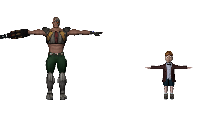

All 3D character models have a rigid skeleton as their underlying structure in common: . The skeleton is covered by a skin (or mesh) on which textures, colors, facial, and body features are applied to distinguish the appearance of a model.
Two models that look different can have very similar skeletons

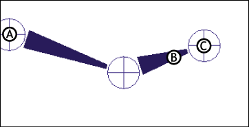

Just like real skeletons, 3D skeletons contain a hierarchy of bones. In a real skeleton, these bones are connected by joints. Skeletal hierarchies allow the figure to rotate around each individual joint.
Arm hierarchy A. Joint B. Bone C. End effector
