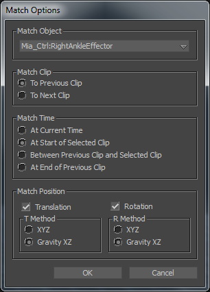

- In the Story window controls, click the Match options
The Match Options dialog displays.
- Make sure the options selected match what is shown in the Match Options dialog figure and then click OK.

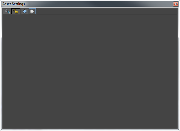

- From the menu bar, choose Window
Add Asset Settings. An empty Asset Settings dialog displays.

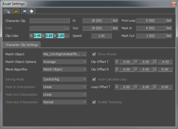

- In the Story window Character Track, double-click the second clip.
The Asset Settings dialog displays the Character Clip settings and options.
- In the Character Clip In field, set a value of 23.
The second clip now starts at frame 23, and cross-blends with the first clip to end at frame 29. This blend creates a slightly smoother transition between the clips.
- Close the Asset Settings dialog.
- Play the animation.
Mia starts and ends her walk in the same pose.
