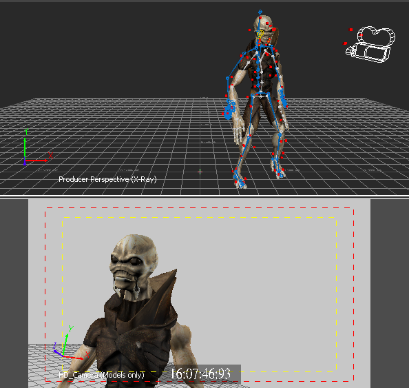

The data you want to capture may be what you see when you look through a Director's camera (although sometimes, the Director doesn't want to shoot cameras at the time the actors are recorded—he's just collecting animation assets for later use).
For example, if you have a scene with motion capture data that shows a Character driven by motion capture markers and a skeleton and marker data driving a constrained camera (as shown in the top Viewer pane in the following figure), you can record the motion capture data, however, what you really want to record is the end result—the data recorded to the camera and the data recorded to the retargeted character. In the following figure, the bottom Viewer pane displays what you see through a Director's camera.

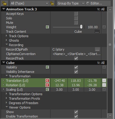

Each take requires a unique name. You can customize tokens. You can add the track name, the timecode, the start time, the end time, the take name, and static text. The purpose of defining tokens for your recording tracks is to optimize recording file management.
You can also enter any alpha numeric string value (no special characters). If you do not enter an iteration value to keep the clip name unique, new clips overwrite current clips.

The contour of the selected Track's
Recording options button (
) changes from grey to green (
) once the recording path is set.
The Track's Recording options dialog displays the recording path and any other changes you made to the track recording options.

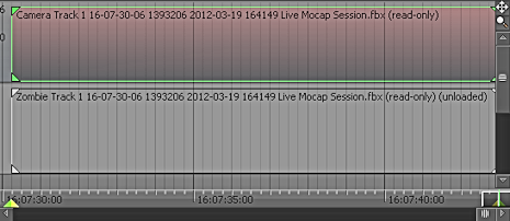

The Story Tracks now represent the recorded data. The recorded data is inserted in the 3D record Editorial timeline. If you manipulate the objects, the animation is recorded.
Story tracks representing the recorded data

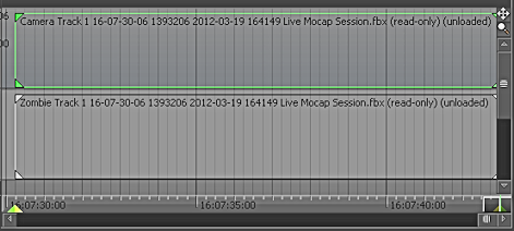

To reload the recorded track into the Story window
The following figure shows one Story Track was selected to be reloaded.
