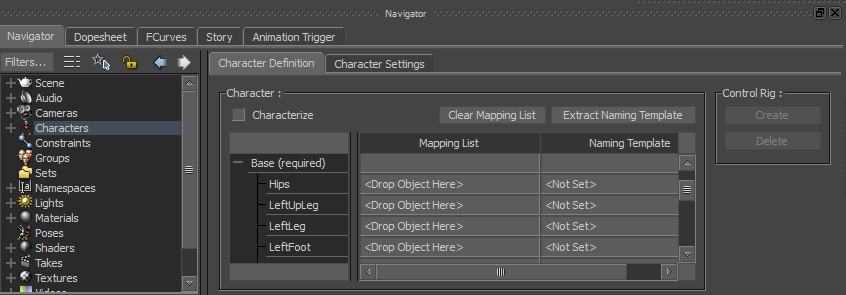

A Character asset is added in the Navigator window Scene browser. The Definition settings for this Character asset are displayed in the Navigator window Definition Settings pane.
Navigator window displaying the Character asset and its Character Settings

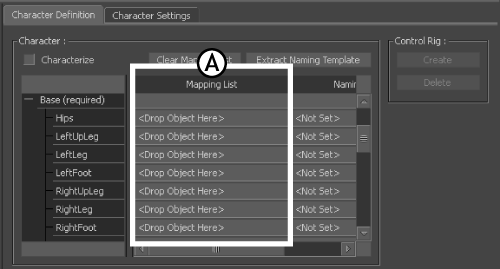

Character Definition pane: A. Base nodes
This group of nodes is required for MotionBuilder to recognize the structure of your character model. If you had automatically characterized this character, the Mapping list would be populated with the character’s bone names.

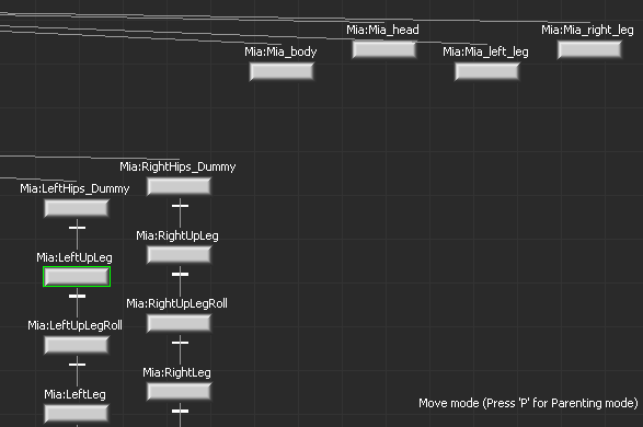

Schematic view of Mia’s structure
The Schematic view makes it easier to select bones from the model’s hierarchy because each bone is represented as a rectangular node.
) to lock the view of the Character Definition pane.
or Ctrl-drag) and pan (
or Shift-drag). These navigation buttons are at the to centre of the Viewer window.

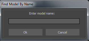

The Find Model By Name dialog appears.

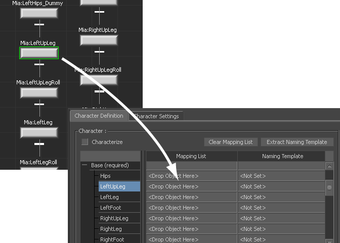

Mia:LeftUpLeg node selected
Mia’s LeftUpLeg node mapped to MotionBuilder LeftUpLeg
When you characterize this character, MotionBuilder recognizes that for this skeleton the LeftUpLeg node is called Mia:LeftUpLeg.
