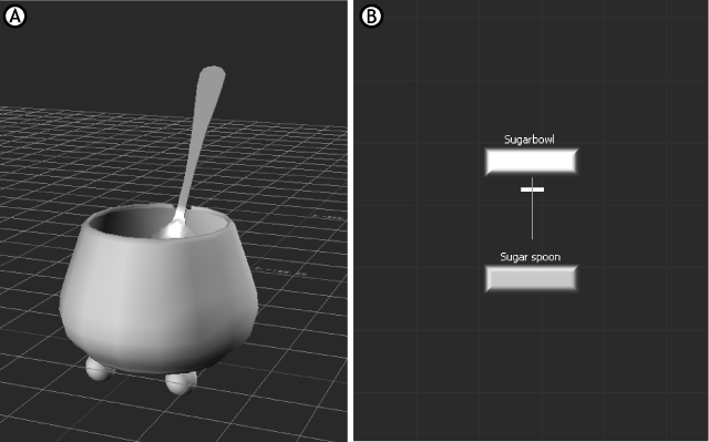

Switches to Parenting mode, so you can create a parent or child relationship by dragging one object to another.
You can create parent to child relationships in either the Camera view or the Schematic view of the Viewer window. To view the parent or child hierarchy, switch to the Schematic view.
Viewer window A. Camera view B. Schematic view
For more information on parenting, see Parenting and hierarchies.
