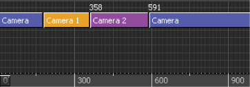

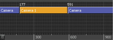

Click Delete Key to delete a camera switch. The Delete Key button removes a selected camera switch in the Switcher timeline and also removes the keyframe from the Transport Controls timeline.
Switcher timeline before the Camera 2 switch is deleted
Switcher timeline after Camera 2 switch is deleted. Camera 1 fills the empty space.

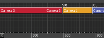

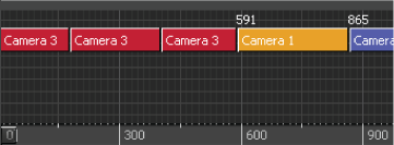

For example, in the following figure, there are three Camera 3 switches. In the figure that follows that, the Clean up button is clicked, and the three switches become one Camera 3 switch that lasts the duration of the previous three.
Three Camera 3 switches in a row
After clicking Clean up, the three Camera 3 switches become one

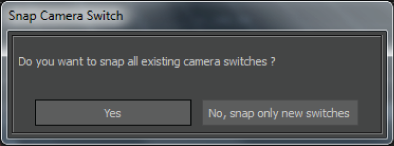

When you select either of the two snapping methods, a dialog box appears asking if you want to apply snapping to all switches or new switches .
Snap Camera Switch dialog box
