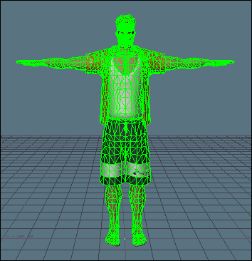

Geometric skin gives the model its outer appearance. Model is shown in a T-stance

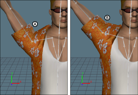

Mesh deformation A. Shoulder mesh deforms at an unnatural angle B. Shoulder mesh deforms naturally
Weight values are measured using a percentage. The higher the percentage, the closer the vertices follow the movements of the bone. For example, with a value set at 100%, the vertex follows the bone exactly. With a value set at 50%, the vertex moves only half as much as the bone.
For deformations to be realistic, you have to associate some vertices with more than one bone. In such a case, any change in the weight percentage relative to one bone adjusts the weighting of the other bones. For example, vertices along the shoulder of a character are influenced by movements of the arms, chest, or spine. To obtain realistic deformations, some shoulder vertices are weighted using arm bones and chest bones, while other vertices are weighted using only arm bones.
