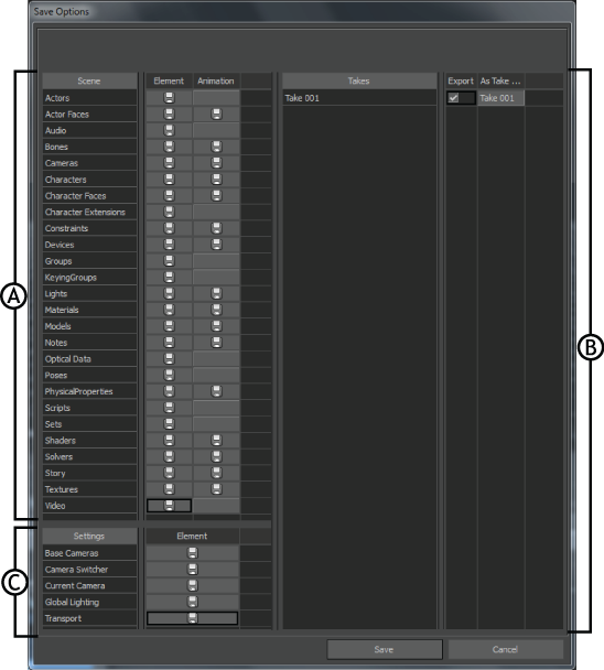

The Save Options window appears after you select Save in the Save File browser.
The Save Options window lets you select assets, settings, and takes options to save from the current scene.
Save Options dialog: A. Assets area B. Takes area C. Settings area
The Save Options dialog is split into three sections:
The Save Options Assets area provides a list of all MotionBuilder assets you can save.

The Save Options Takes area shows all the takes in the scene. Use the Takes area to select which take(s) to be saved with your .fbx file. The Save Options Takes area consists of the following settings:

The Save Options Settings area lets you choose MotionBuilder settings to save with your file.
The Save Options Settings area consists of the following settings:
