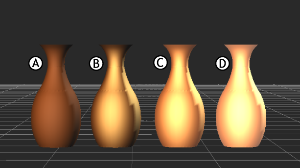

The following image shows a progression of changes to the basic Material settings to create an effective color and lighting result. See Adjusting material color.
Material settings results A. Diffuse color alone B. Specular color with Diffuse C. Ambient color added to Diffuse and Specular D. Emissive color added to the result
Diffuse refers to the actual color of the object. In the figure above, the vase is orange.
Specularity refers to the color of the highlight that appears on the object. Depending on the intensity and spread of the specular highlight, a brighter, lighter color gives a sharp, shiny effect.
Ambient refers to the color that shadows are filled with on the object, to simulate color that bounces off of a nearby object. For example, a white sphere next to a red wall would have at least a bit of red as an ambient color.
The Ambient color is dark gray by default, but few shadows are truly gray. By changing the Ambient color, you can simulate various lighting effects.
For example, when objects are placed close together, light bounces between them, causing the color of one object to affect the color of the other, depending on the substance of the object. To choose the most realistic shadow color possible for your model, look at the color of the other models in the scene to see what would make sense.
Also, always keep in mind the substance you are trying to simulate; a rough or matte surface takes on less color from other objects than a smoother or more reflective surface.
Emissive refers to the color of the light that radiates from the object. For example, choosing a bright color with high intensity gives the effect of a radioactive glow.
