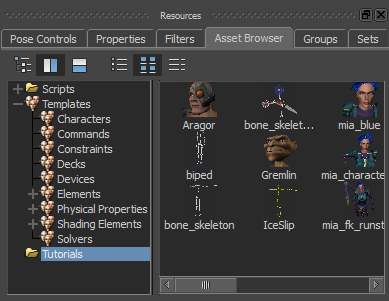

The contents of the Tutorials folder appear in the display pane, in Thumbnails display by default.
Tutorial assets displayed in thumbnails

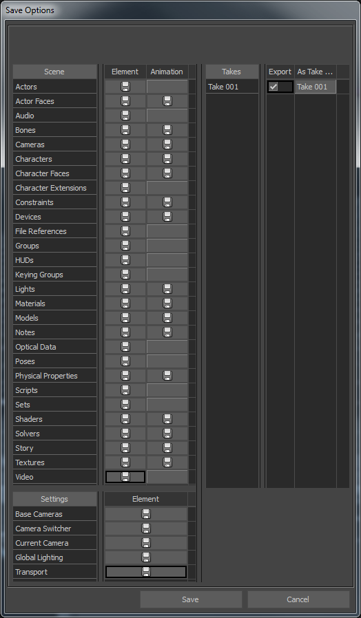

 Save As.
 Save As. The Save File window appears.
The Save Options dialog box appears.
Save Options
Choosing to save the file to a directory other than the default MotionBuilder Tutorials directory ensures you do not overwrite the original .fbx file.
