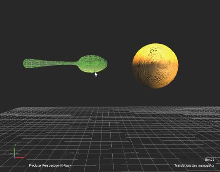

- Drag a Rigid Body Physical property from the Asset browser Physical Properties folder onto each object you want to join.  A Rigid Body property is dragged onto the Spoon
In this example, a Rigid Body property is added to the Spoon object.

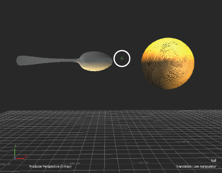

- Drag a Null element from the Elements folder into the Viewer window and position it between the objects for which you want joint behavior. This null becomes the pivot from which the joint action is based. You can use any object as a pivot point, but the joint orientation for physics is read from the local orientation of the pivot object.   A. Drag a Null element between the objects.

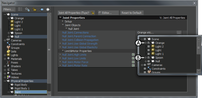

- Select Joint in the Navigator window Scene browser and expand Setup and ensure that the Joint is set to Active. Then select the affected objects in the Null Joint Connections asset list.  Select the element affected by the Joint behavior. A, (Orange), and B, (Spoon) are the objects in this example.
In this example, the Orange and Spoon are the affected objects.  You can also drag objects to the asset list, which lets you choose the hierarchy order by the order in which you selected the objects. In this example, if you select Spoon first, it becomes the parent, and if you select Orange first, it becomes the parent.
- Select a Joint Type from the Joint pane Type menu. See Joint types for a description of different joints and their behaviors. See Joint settings for more details about what each setting represents.

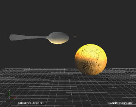

-  Double-click Solver in the Scene browser Physics Solvers folder to expose the Solver pane and click Live.  Orange swings from Spoon.
