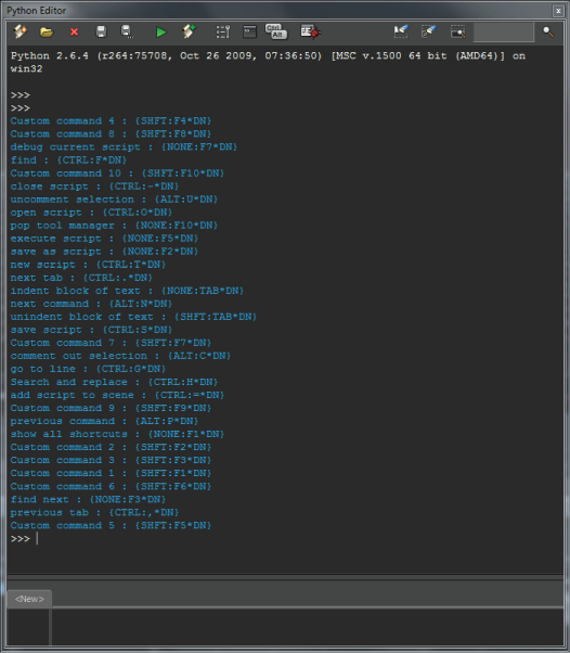

To access the list of Python Editor keyboard shortcuts:
Python Editor. The Python Editor window displays.
Python Editor commands keyboard shortcuts
The Python Editor interactive console displays the list of Python Editor keyboard shortcuts.

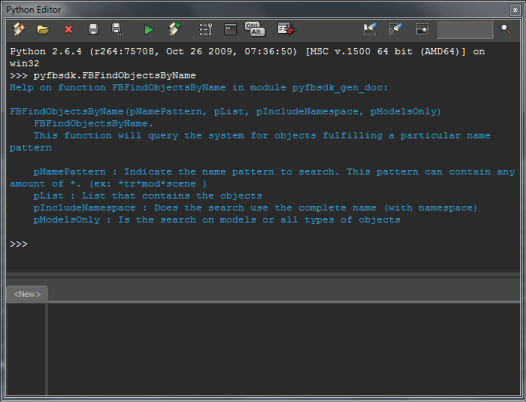

To display context help related to a command in the interactive console:
The Python Editor interactive console displays help related to the command entered in the interactive console.
Help about a command in the interactive console

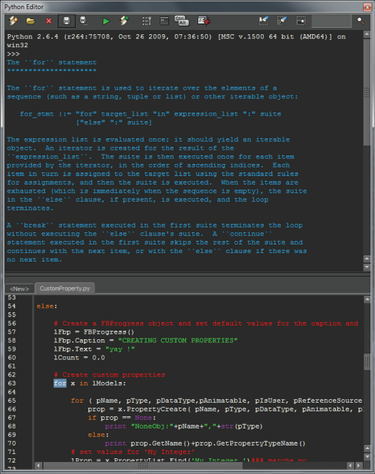

To display context help related to selected content in the interactive console:
Help related to the selected text is displayed in the interactive console.
To display context help related to selected content in the work area:
Python Editor interactive console displays context Help
Help related to the selected text in the Python Editor work area is displayed in the interactive console.
To display context help related to the content in the work area:
Help related to the text in the work area is displayed in the interactive console.
