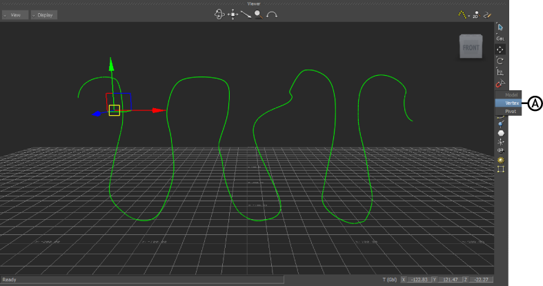

To adjust the vertices on a 3D Curve:
In the Viewer window, the color of the 3D Curve changes from red to green, indicating it is selected.
Viewer window Object selection buttons A. Vertex.
The points on the curve transform into editable points with tangent handles.
3D path in Edit/Delete Points mode.

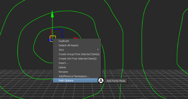

To add points to a curve:
Add Points Mode from the context menu. The cursor changes to a crosshair.
3D path context menu A. Add Points Mode
