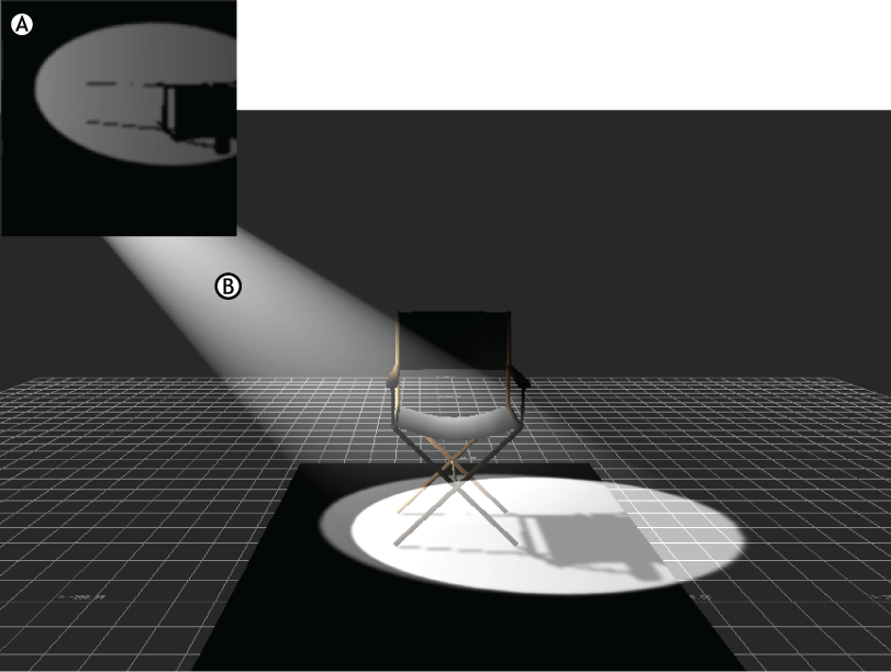

Map shaders take a “snapshot” of the scene at the moment it is rendered, and applies it to an object as a Shadow Map texture.
Map examples A. Created map B. Scene with the shadow map applied to the floor plane.
The Shadow Map shader is a useful alternative to live shaders as they do not demand much of the system’s resources to display. Use the Shadow Map shader to apply a shadow image to an object or a plane.
