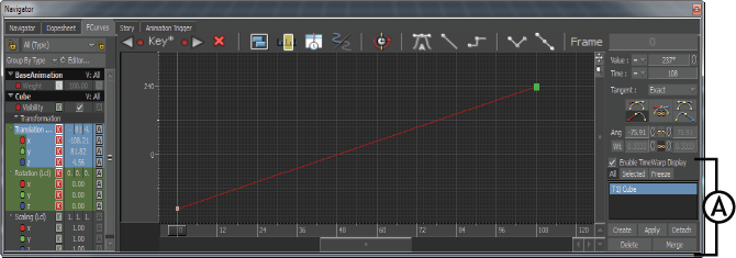

A. TimeWarp pane
The TimeWarp pane includes the following options and buttons:
Activates the TimeWarp pane and displays the selected TimeWarp curve of a function curve.
Displays all TimeWarp curves in the scene.
Displays TimeWarp curves for selected properties in the FCurves Properties pane.
Freezes the current TimeWarp list, until you choose All or Selected.
The TimeWarp list is empty, by default, until you create a TimeWarp curve (see Creating a TimeWarp curve).
Curves are listed in the TimeWarp pane and numbered “Tn”, where n is a reference number for the TimeWarp curve. The name is based on the object last selected in the FCurves pane. If nothing is selected, the curve is numbered and called “No Name”.
Creates a TimeWarp curve. See Creating a TimeWarp curve.

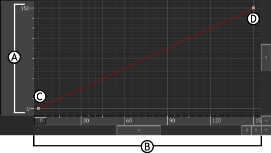

A. Original animation values on Y-axis B. TimeWarp animation values on X-axis C. Beginning of time D. End of time
Applies a TimeWarp curve to its selected property. See Applying a TimeWarp curve.
Detaches a selected TimeWarp curve from its function curve, and returns to the original motion data. See Detaching a TimeWarp curve.
Deletes a selected TimeWarp curve. See Deleting a TimeWarp curve.
Merges a TimeWarp curve with its function curve and makes the curve permanent. See Merging a TimeWarp curve.
