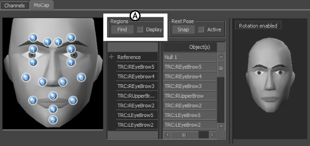

After setting up the Marker Set list, use the Regions area to define the zone of movement for the model’s main facial components. The Regions area is available only when the Active option in the Rest Pose area is disabled, and consists of the Find button and the Display option.
MoCap pane A. Regions area
The Find button automatically defines the zone of movement for the facial markers using bounding boxes around the mouth, eyes, cheeks, nostrils, and eyebrows. The face must be in the rest pose and be pointed towards the Reference positive Z-axis.

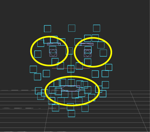

To display the bounding boxes in the Viewer window, activate Display after clicking Find. Bounding boxes appear as purple cubes around the eyes, eyebrows, cheeks, and mouth of your face model.
Bounding boxes display in purple around the eyes, eyebrows, and lips of the optical sensors. Cheeks and nostrils are not defined for this Marker set.
Bounding boxes are Rigid bodies that limit the area in which of your face model can move. If the shapes are set to move outside of a bounding box region, they do not reach to their full values.
