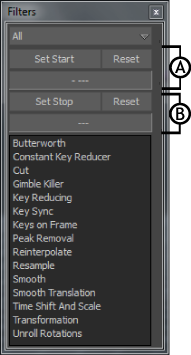

Depending on what you select to filter, different filters and options appear in the Filters window. The Start and Stop areas and the group of buttons (Preview, Reset, Accept, and Cancel) at the bottom of the Filters window are common to all filters.
Filters window A. Start area B.Stop area
The Set Start button sets the start of the filtering region to the current time, and the Set Stop button sets the end of the filtering region to the current time.
Filters window (detail) A. Start field B. Stop field
The Reset button clears the Start or Stop field. When no values display in the Start or Stop fields, applying a filter affects the entire function curve.
