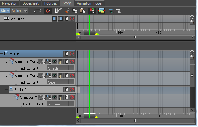

Before you begin recording, you need to set the recording path for your Story Folders and Tracks. The recording path needs to be defined for each track you want to record with the exception of tracks within a Folder. For example, you can set a path for a Folder in the Story window and have the Tracks within that Folder point to the same path. You can also set a path for a Folder in the Story window and another path for the Tracks within that Folder. This applies also to nested Folders and Tracks. Complete lower-level paths overwrite higher-level paths, while a hierarchy of incomplete paths is assembled to form a complete path. This enables you to specify only the subfolder in the track, while the folder contains the base path..
To set a recording path for a Story Folder:
Story Folder shown selected
The Story Folders, unlike the Story Tracks, do not have a

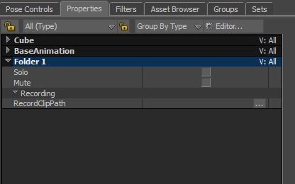

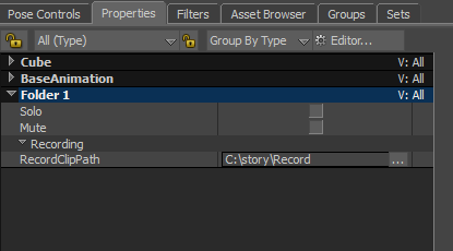

The recording paths for all Story Folders are set via the Property Resources window.

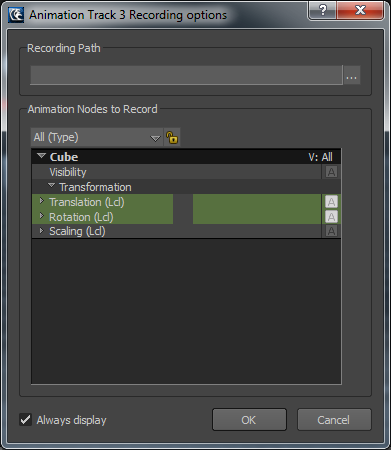

To set a recording path for a Story Track:
) or
Recording Options menu (
) in the Story window.
), or
) followed by the Recording options menu
The properties shown in the Track's Recording option dialog are the properties that can be animated and therefore recorded.
The default activated (
) recording properties shown in the preceding figure are the Translation and Rotation properties
